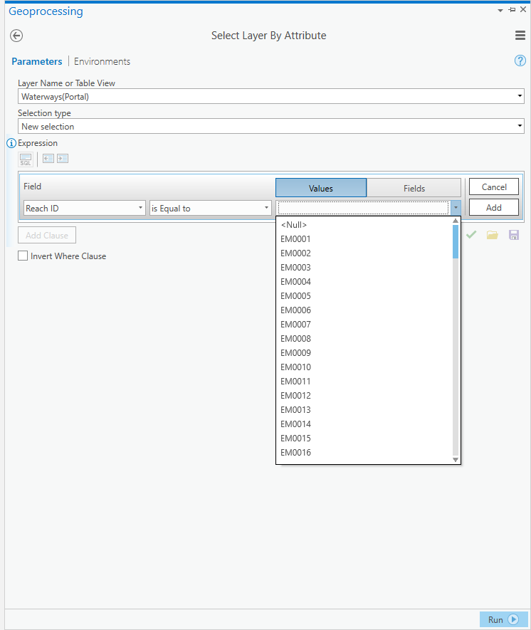

Last week I ran into some confusion when trying to use a FieldName is not null expression.  See https://community.esri.com/thread/211900-arcgis-pro-select-by-attribute-is-not-null .
There were a number of records that had the string '<Null>' entered as the value which threw me off my game considerably.  I talked to the data owner and he jumped on the problem immediately making the proper corrections.
Today I looked at the data again: it's a feature layer that is published from an enterprise geodatabase feature class to our local portal: the data owner made the edits to the e-gdb feature class.  Now when I look at the data via the Select by Attribute tool in Pro, I still see <Null> listed as a value. The expression:
Reach ID  is Equal to <Null> fails  as it should
while Reach ID Is Null works, as it should
and Reach ID Is Not Null works as it should
However I still see an issue with the way Pro displays string field values with out quotes: the list displays <Null> as a valid value.  After last week's foray, I still would consider this a six character string. ( <,N,u,l,l,>), but it isn't.

Joe, when using the Select Layer by Attribute tool with GDBs (not sure about AGOL/Portal layers), if you see <NULL> in a Values list for a string field, then you have <NULL> written out as text.  The Values list never populates NULL (if it is truly NULL and not NULL written as text), so if you see it in their, it is a string.
I assume AGOL/Portal layers are the same, but I will have to check and post back.
JoeBorgione
MVP Emeritus
They are in fact text- the data owner hadn't fixed them. But....  I tried a selection where FieldName is Equal To <Null> and it failed.  I can't remember now what the error was and now the owner has fixed the data, so <Null> no longer appears in the list.  And that's all that matters to me at this point!
