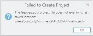

When creating a new project (Project A) from a project template from ArcGIS Online in the ArcGIS Pro start screen, some of the testusers got this errormessage
After that message, ArcGIS Pro was unable to open any other project until it's restarted. When ArcGIS Pro is restarted, the project  created (Project A) is opened correctly. When trying to create a new project from a project template (with a existing project opened), the project is created and opened correctly.

I figured it out myself. The problem actually had to do with one of our ArcGIS Pro Addins. The addin was overriding the event ProjectOpenedAsync for checking some map-names in the project. When I changed the code to using the event ProjectOpened, it works perfectly.
