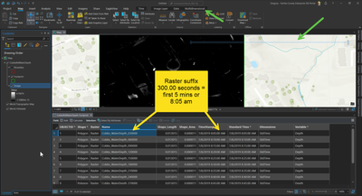

I'm getting there. I created a mosaic dataset and added the flood depth rasters to it. I added a date field, TimeStamp below, and set the date for the storm I'm modeling (July 8, 2019 from 8-9 am) using the raster suffix to get the 5 minute intervals. I used the Build Multidimensional Info tool to make this a multidimensional raster. You can see the multidimensional tab and time slider are activated and I can publish this as an image service. Not as cool as watching the water move in the Pro simulation, but close.
