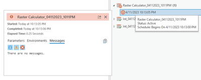

Hi! Having huge issues using the scheduler in ArcGIS Pro (64-bit) for geoprocessing, and there is hardly any knowledge online about the scheduler itself. I'm just trying to run the Raster Calculator with the scheduler, which of course sounds very simple. However, trying to perform this simple task has led to literal weeks of scouring forums.
Basically, I have two .tif files stored on my local computer. Not a on VM, not on a server, they're stored locally. My code simply compares the intersection of certain values:
("2001.tif" == 0) & ("2023.tif" ==1)
In this example, I'd be looking for specific pixels that have a value of 0 in 2001, and a value of 1 in 2023. Easy!
Now if I just run this off the bat, there's no issues. It's for a country-sized area, so it takes some time, but no problems come up. However, the second I try to run this through the scheduler, nothing works. The command will run for about 0.2 seconds, fail, and will say "There are no messages." leaving no way of knowing what's gone wrong.

I'm running into the same issue. I actually have a simple geoprocessing tool that has run in the scheduler every day for nearly 70 days without any issue. But now it just won't work when run in the scheduler. It returns a non-specific error.
What's most confounding is that if you r-click the scheduled task and choose 'open' and then run it as a regular geoprocess, it runs just fine.
