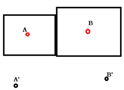

I want to find the distance between 2 points with the same ID. Here is the illustration: I want to find the distance between A and A" and also B and B".
Point Distance (Analysis) does not do this kind of processing.

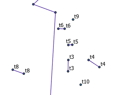

The IDs of paired points are exactly the same, aren't they? If yes, just try to build two-point lines for each of the paired points by grouping input points by IDs. The lengths of these lines are the distance you are looking for.
SeaRM
yockee
hi @SeaRM  yes. you are correct.. i just tried it and it works as intended . thanks mate
