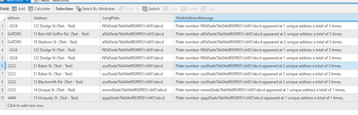

I added a text field (MultipleAddressMessage) to my table and populated it like this using Calculate field using an Arcade expression:
Using this Arcade code:
var License = $feature.LongPlate
//get all records having the plate in this record
var test = Filter(FeatureSetByName($datastore,"TestPoints",['LongPlate','Address'],true),"LongPlate = @License")
//Use GroupBy to get the stats you want - return type is another feature set.
//returns a feature set having an Address column and a NumberOfAddresses column
var result = GroupBy(test,'Address',{name: 'NumberOfAddresses',expression: '1', statistic: 'COUNT'})
//Check for null Feature Set
If(IsEmpty(first(result))){
  //if null return 'not parked'
  return 'not parked' //should never happen but have to test for null
} else {
  for(var instance in result){
    //Step through GroupBy returned feature set and derive the values you want
    var TotalInstances = TotalInstances + instance.NumberOfAddresses
    var NumUniqueAddresses = NumUniqueAddresses + 1
  return "Plate number: " + first(test).LongPlate + " appeared at " + text(NumUniqueAddresses) + " unique address a total of " + text(TotalInstances) + " times."

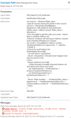

Thanks, that looks promising, but my arcade skills are below average. For my data, I'm substituting your "LongPlate" with my "Plate_value" and your "TestPoints" with my "LPR_Data519_520_NoPermit". I'm getting an error on line 6, my code is pasted below
var License = $feature.Plate_value
var test = Filter(FeatureSetByName($datastore,"LPR_Data519_520_NoPermit",['Plate_value','Address'],true),"Plate_value = @License")
} else {
  return "Plate number: " + first(test).Plate_Value + " appeared at " + text(NumUniqueAddresses) + " unique address a total of " + text(TotalInstances) + " times."

I don't see an error in the code....I guess you could try substituting 'Address' for '1' after the expression: keyword in line 6... but that seems like a long shot.
Is your data coming from portal or AGOL, or straight from a geodatabase?  What version of ArcGIS Pro are you using?  Are you sure your license plate number is a text field?
If the data is coming straight from a database and your pro version is 2.5 or newer and your GUID looking ID is indeed in text format, then I'm think there might be something "off" in you data.
What that something is I don't know, but I don't believe in coincidences (much) and it seems like a coincidence that no matter the potential solution, it gets to a certain point and fails... each time with a new message.
You could try exporting out a very small subset of your data (like ten records) and testing the process against that.  If it works or it doesn't its a clue.  If it works, its a clue that one or more records in your input data have something in them that is disrupting ArcGIS.  If it doesn't try substituting some "simpler" plate numbers (something like "ABD123") in the your test data and trying again... or simpler address ("1234 ABC ST W")... if that fails I'm at a complete loss.
Sorry for sending you down rabbit holes, but that's all I can think of.
MattCotterill
OK, I'm running 2.3.1 so it sounds like that's the most likely problem here. I'll start by badgering our IT department to install the latest update. Once I get updated, I'll take another crack at it.
Thanks for your help!
KimberlyGarbade
I think that clears up the Arcade error. I don't think GroupBy works in versions per 2.5.
