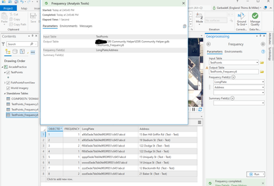

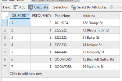

You can use the frequency geoprocessing tool:
Original Data:
Frequency Table generated by tool:

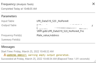

Hmmm... I'm getting an empty output with this one as well. But that looks like what I'm looking for.
KimberlyGarbade

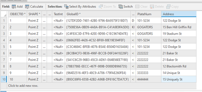

Hmmm.... I didn't do anything "fancy" (below).  Can you share a screen shot of your data's table as an example? Also, what are the field definitions of "Plate_value" and "Address"?
MattCotterill
Plate_value and Address are both text fields. Is that what you're asking? I'm getting the same error message when I try the "Find Identical" tool (see above) so maybe there's a problem with the feature class?

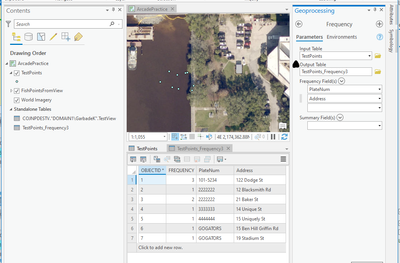

That plate value field is quite the value... let me test with a GUID like number and very verbose addresses... Still works for me (see below).
Have you limited your selected features somehow.. you mentioned a definition query (I also applied one to my test and it had not effect on it working, but maybe yours returns zero records or something odd like that).  You could try export your data to a new file GDB and then running the tool against that data using the same file GDB to hold the generated stats table.
