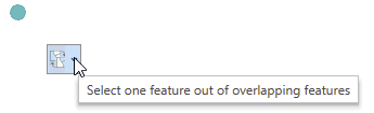

Try using Add Spatial Join setting the Target and Join Features to the same point feature class with the Intersect match option. The Join_Count field will display the number of matches and 2 or more signals an intersect. You can then select intersecting features with a Select interactive tool and then expand the widget and select features.

BarryNorthey
