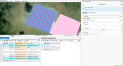

DanPatterson
Find Identical (Data Management)—ArcGIS Pro | Documentation
should work if you only specify the Shape field and no other field

@DanPatterson Thank you for your response. I am aware that this should work using Find Identical. However, I do not have an Advanced license at my current position and the cost differential between Standard and Advanced is difficult to swallow on a tight budget. I would think that this is a fundamental enough analysis that it would not require thousands more dollars per year to be able to access. @BruceHarold Thank you, I believe we may have Data Interoperability, so I'll check that out. The bottom line is I believe this analysis should be available to users without additional cost beyond a Standard desktop license.
KellyWright
@DanPatterson I should have clarified that I was not 100% positive this would work with Find Identical, but that someone in an Esri UC session just today pointed out that it would work if only using the "Shape" field when finding identical segments. So, thank you for confirming this functionality in the Find Identical tool!
KoryKramer
Thanks @DanPatterson
Closing this as Already Offered using Find Identical with only the SHAPE field as input.
