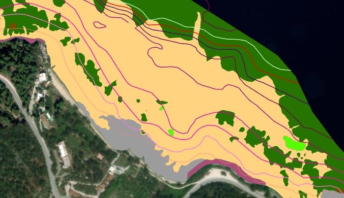

Hello ESRI Community,
I have the following problem. I have created polygons for habitat features and the isolines, too. I try to find the area (or at least a way to select) of a polygon between two isolines. The polygons are already splitted to the borders of each isoline.
I tried select by location but there is no option between two features. Is there any idea?
Screnshot shows the habitat map and the isolines.

You could use Select  by Location, with a small distance, to select polygons near one of the contours, and the use Select by Location again to select from within that selected set the ones that are near the other contour too.
