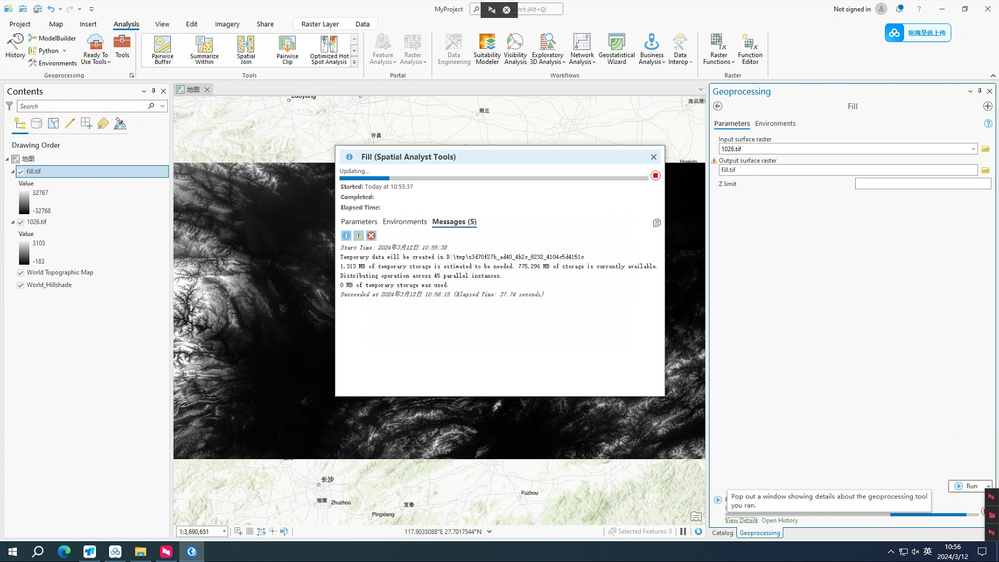

when i run the fill function and set parallel factor not zero.
i encounter this problem.
it quickly passed without any warning or failure code.
however if i set the parallel factor to 0, it can run, but too slow.
i also changed the tmp folder follow the official guidance to D:\tmp. yet still failed

Did you see the discussion, limitations and warnings in the documentation?
Fill (Spatial Analyst)—ArcGIS Pro | Documentation
Parallel processing with Spatial Analyst—ArcGIS Pro | Documentation
Notes about the drive type may be pertinent regarding your D:\tmp as well

i have change the tempfolders as D:\RasterCache. still cant work :(.

There were other points in the help topic that needed to be addressed.  It is unclear from your initial message what the problem is since you seem to have a valid output and the message window doesn't report an error
