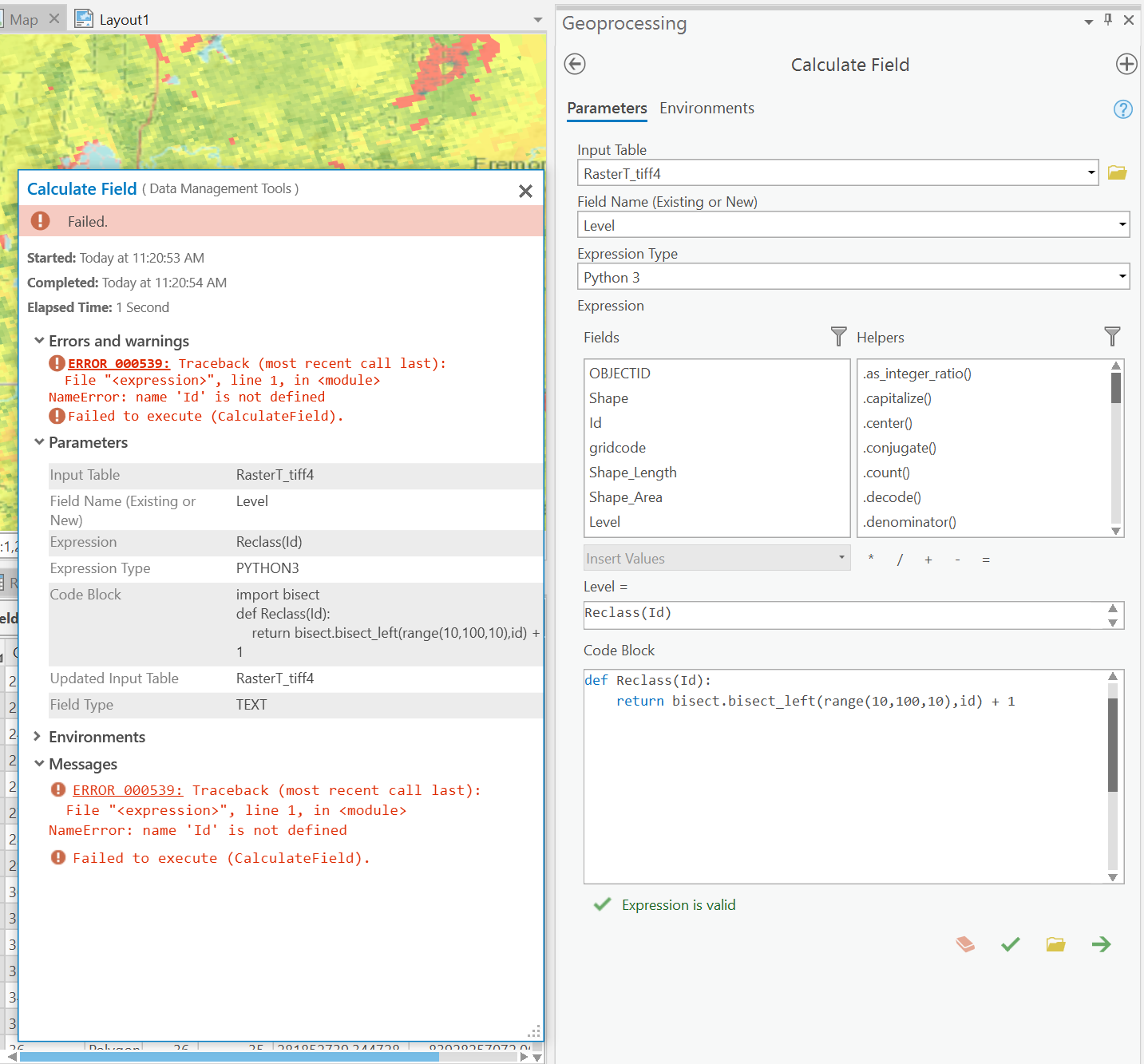

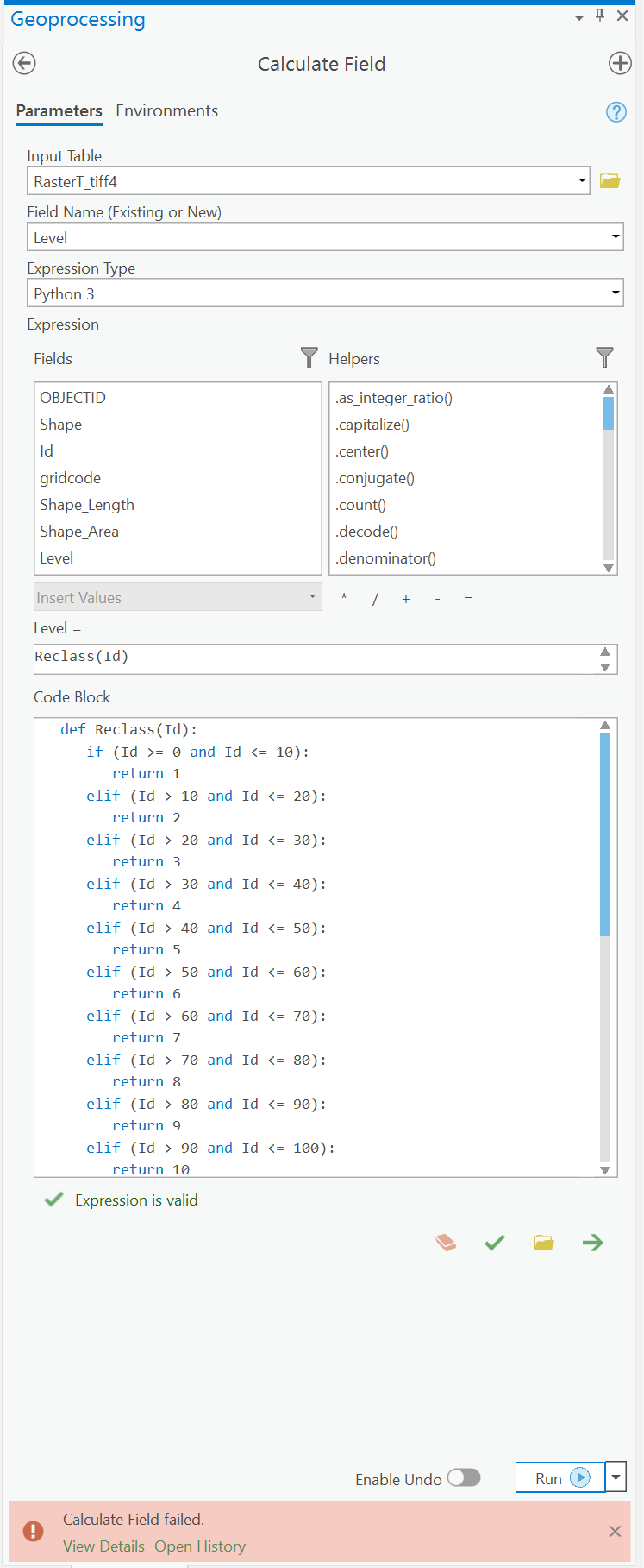

ChrisCowin
Hi Dan,
This is something that I had originally tried, the Level there was just the most recent thing I had tried and when I ran out of things to try I came here. When I try either change you suggest I get a "parameter missing error" in red text at the bottom of the window.
Why isn't it a good idea to use a field name and what would I use alternatively?
Here is a picture of the window if that helps.
JMutunga
Hello Chris,
You are headed in the right direction here. COuld you send a screenshot of the error details? Since the code validated successfully, I suspect that the 'Id' field data type is not a numerical type (short/long integer or double) since the code is trying to write such values there.
Regards,
Josphat.

ChrisCowin
Unfortunately I get the exact same error as I did before...
I tried changing ID to Level just to try and it gave me a new error but i think it got farther into the code.
JoshuaBixby
MVP Esteemed Contributor
The issue in the first screenshot is that you are not passing the field correctly.  If the field in the GDB is called, Field1, then you pass it in the expression box as, !Field1! .The Id variable that is defined by the function is only used within the function.  The variable name for the parameter in the function and the field in the GDB don't have to match.
My original code has a typo, I should have capitalized I in id on the usage in bisect function.  I have updated the code.  In your case, if the parameter name is "Level", then you need to use "Level" in the code and not "level".  Python is case sensitive.
