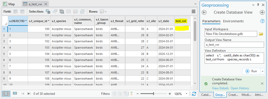

I can create this FGDB database view without errors:
select
  s.*,
  cast(t_date as char(50)) as test_col
from
  species_records s
However, the field that uses CAST is blank in the attribute table. That's not expected.

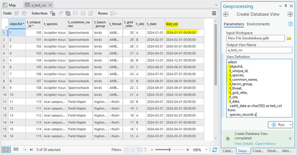

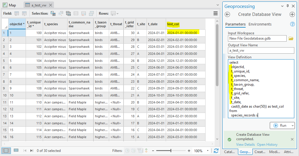

I don't have that problem if I remove s.* and replace it with the fields listed one by one:
select
  objectid,
  t_unique_id,
  t_species,
  t_common_name,
  t_taxon_group,
  t_threat,
  t_grid_refer,
  t_site,
  t_date,
from
  species_records s

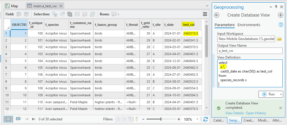

And I don't have the s.* problem in a mobile geodatabase view (although the date is displayed as a number, not a textual date, but maybe that's expected for SQLite date fields):
select
  s.*,
from
  species_records s
Question:
Why does casting a date field in the SELECT clause result in a blank column — when the query uses s.* ?
