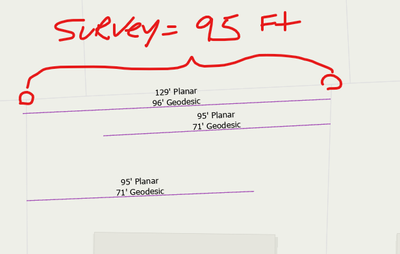

Yes, but my problem is that I also need to add lines based on survey data (see image below. Back of property line is 95', if I use the Edit/Distance tool and type 95... it doesn't match).
I which we could have the option to CHOOSE between Planar and Geodesic when editing Web Mercator Auxillary Sphere data

I understand Dominic - you may want to consider adding an ArcGIS Pro Idea for the option to choose between planar and geodesic when using the Web Mercator coordinate system.  That way others who feel similar may vote it up.
