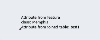

If you are using a table "Joined" to the feature class the syntax is like this (I.E. $feature['tablename.attributename']:
"Attribute from feature class: " + $feature['CityTestPoints.CityName'] + TextFormatting.NewLine + "Attribute from joined table: " + $feature['TestData.TestField']
 gives you:
Is this what you are asking about, or are you using a relationship class to associated the feature class with the related table data?

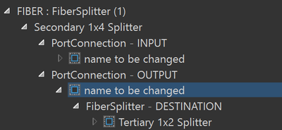

I'm not trying to generate a label in the map, if that's how the problem came across. I'm very new to ArcPro and so there are unknown unknowns about how everything is tied together in the database we're using but I believe it's the latter, a relationship class. The heirarchy in the attribute pane is
A new relationship is created in the tertiary splitter and that relationship is then added to the input or output section of the secondary splitter feature. "name to be changed" is related to the two objects (?) but neither of the splitters are related to each other. "name to be changed" has a field value equal to the tertiary's GID and I want to replace "name to be changed" with values from the tertiary so I can at a glance tell what tertiary splitters are related to the secondary without all the clicking.

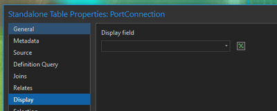

I've successfully retrieved the info I'm looking for but the display name won't actually update in the attribute pane and I don't know if perhaps the expression is too computationally expensive and Arc defaults back as a result? Is that a thing? The display option in the table properties is actually blank when I check versus <expression> like it is for other custom labels.
