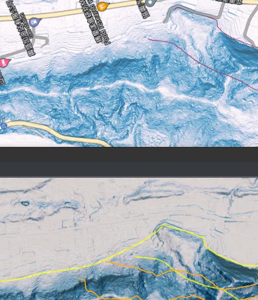

After creating the line feature class in Map, it just disappeared. In order to check the existance of my feature, I use the selection tool. The results show that my "invisible" feature is selectable and it can be displayed in the Scene.
I've updated my ArcGIS Pro to version 3.0.1 but the problem can not be solved.(yellow line in the lower partof the picture)
I wonder that how this issue can be solved.
The picture shows that my feature(yellow line in the lower part of the picture) is not displayed in Map(purple line in the upper part of the picture) but displayed in the Scene(yellow line in the lower par tof the picture)

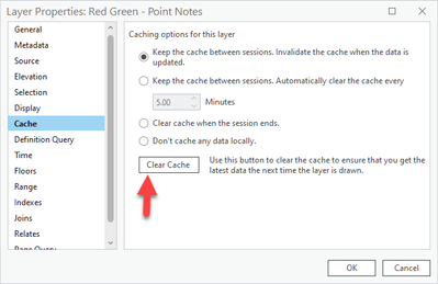

@TINGYUBAI try clearing the cache on the layer (right-click on the layer > Cache page):

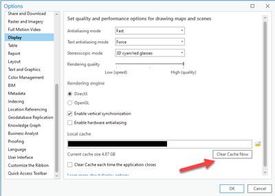

If that doesn't work, try clearing the display cache for the application (Options > Display):

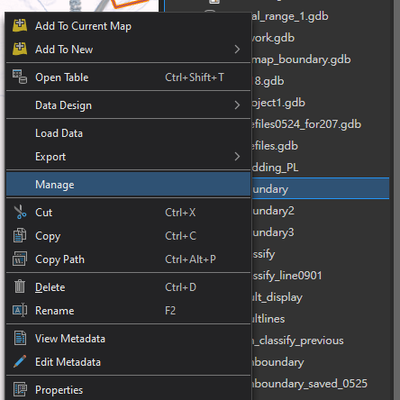

I have the access to recalculate the spatial index, but failed to process(Fig. 1).  I tried to shut down QGIS which is connected to my feature class and looked for the Lock pane, the former got no use, as for he lattter, I folllowed the step mentioned in documentation, and couldn't find the lock pane.(Fig. 2)
