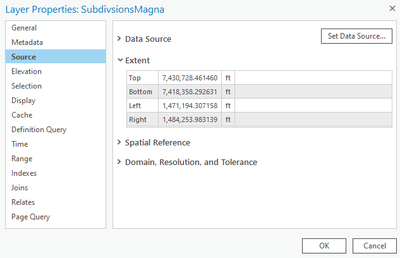

I created a new empty feature class and then appended features into it from another feature.  When I zoomed to that new feature class, it zoomed way out as if the extent was whacked; and it was.  So I used the recalculate feature class extent tool and it was still whacky.  Then I recalculated the the spatial index and it zooms correctly.
However, when I look at the feature class properties I see these Max/Mins:
But when I use arcpy.Describe I get slightly different values:

Two questions:
1. Why did I need to recalc the spatial index to get my extents to behave?
2. Why do I see different values between the properties pane and  arcpy.Describe?

coordinates were in meters, hence the feet-meters difference
you have to recalculate the spatial index because the empty featureclass probably didn't have and extent or it had one in a different coordinate system.
First issue can be fixed by working only in meters 😉 or wait 16 days
