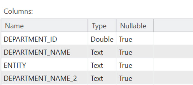

Something that worked for me is review the data type for columns I wanted to display in my query. Turns out one of my columns was a double and not able to be read in ArcGIS Pro's query layer as a double. Used the function CAST as Varchar(100) and that seemed to do the job. There were multiple columns that needed to be converted from the original data type to Varchar(100), eg - one other column as data type of Big Int which also wasn't coming across. Hopefully this helps others in the future.
