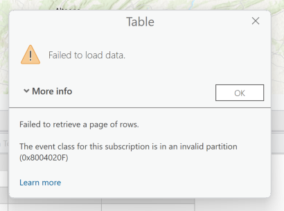

Received the following when trying to view the attributes of a view in ArcGIS Pro. Other similar views work fine. No idea what this error means. Any thoughts?

I've encountered this same message, and I too am confused.

I also got this error in ArcGIS Pro 3.3.1 when trying to load all 139,396 rows in the attribute table of a feature class in a 10.8.1 enterprise geodatabase running on Oracle 19c.
Failed to retrieve a page of rows.
The event class for this subscription is in an invalid partition (0x8004020F)
After clicking OK on the error, the attribute table closes. Trying again yields the same result.

Has anyone gotten anywhere with this? Got same on a SQL view in Pro 3.4. I'm going to open a support ticket.

I'm getting the same error trying to open a view. Any updates on this? Could anyone find a workaround?

My issue was that I had duplicate IDs in the field I had designated as ObjectID. Hope that helps.
