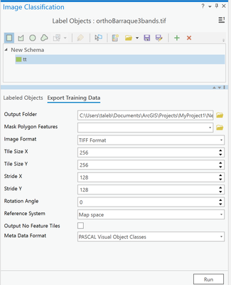

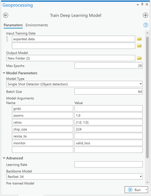

talebbenEsriPublic
thank you for your reply, the image format is Tiff and cel size= 0.08
for more details on the data inputs see the screenshots below.
thanks for your help.

Hi @talebbenEsriPublic you may have already solved this. If yes, can you please share how you solve it?
If you have not, please take a note of "ValueError: could not convert string to float: '58,82'" and your 1st screen-capture. Looks like there seems to be a language / local issue (comma vs. decimal).
