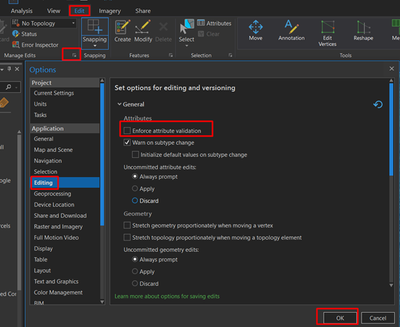

Scott_Harris
@WahkiakumGIS
If you set the Enforce attribute validation editing option to off, you should be able to create features that don't fall within the domain.
https://pro.arcgis.com/en/pro-app/latest/help/editing/change-general-editing-tool-settings.htm#ESRI_...
Does that help?
-Scott

Scott_Harris
@WahkiakumGIS
Does that help?
-Scott
WahkiakumGIS
Hi Scott,
I made the changes you suggested and now I am able to create features and enter the attributes afterward without having to use any placeholder domains at all. Thanks a lot for the help, I appreciate it.
