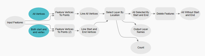

You can even do start & end in one pass, something like:

If you want to do this in model builder do this:
  1. Extract all vertices
  2. Extract start vertices
  3. Extract end vertices
  4. Use start vertices to select intersecting all vertices
  5. Use end vertices to add to selection intersecting all vertices
  6. Delete selection from all vertices.
This can very easily be done in modelbuilder.
DavidSolari
MVP Regular Contributor
DuncanHornby
MVP Notable Contributor
Fine tuned to perfection, nice! 🙂
