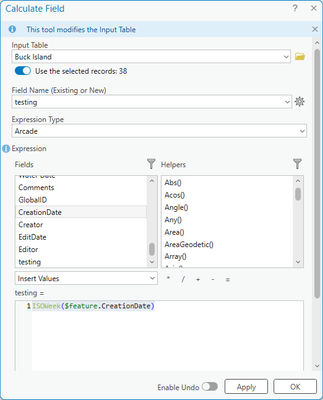

KenBuja
MVP Esteemed Contributor
You can use the Arcade script
ISOWeek($feature.surveydate)
This is how it would look in the Field Calculator (with my data)

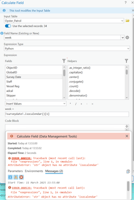

I've tried the the isocalender but I'm getting an error posted in the reply to Dan,

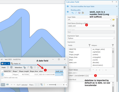

or via python builtins.  You just need to add an integer field to get the week number

RachelS
Hi @DanPatterson
Yes, this is the code I tried but I got the error message below.
My surveydate field is type 'Date' like 03/12/2024 16:44:00.000.
I thought it was because my week field was a string but when I created one that was an integer 'Long', I still get the error below.
DanPatterson
you date field was a string that was the problem, if you try it with a true date field as input and the output field (week) as integer (long) it should work, as in my example

RachelS
Hi @DanPatterson
That's interesting, how do I get the field to be a true date field? The properties of the field in ArcPro is 'Date' type.
I even created a new field in ArcPro as type Date, copied over the data and ran it but it still did the same.

RachelS
Hi @JoshuaBixby
The code I tried is in Dan's reply above but I get the error in the screenshot posted above.
The sample date is 03/12/2024 16:44:00.000 and in another field called week I'd just like to get it return 49.

KenBuja
