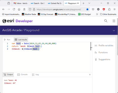

KenBuja
MVP Esteemed Contributor
There's difference between the two. Week returns a value where the first week is 0 while ISOWeek returns a value where the first week is 1. Take a look at the difference using your example date (remember that month is zero-based)
