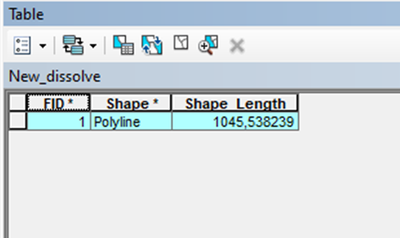

Hello,
I have a shapefile that contains one line, and I need to extract the "Shape Length" value from his attribute table using python.
Any suggestion?

MohamadAchour
I only need the value of the "shape length" cell. Then, I will use this value in the script.
MohamadAchour
if there is a method to calculate the length of the polyline also it can work.
