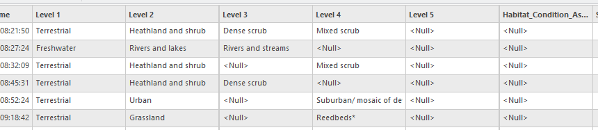

Hello all,
I am working on a habitat mapping feature layer and need to write an expression to exclude null fields.
I have the layer setup with 5 fields utilising contingency selects (which is also not currently working on ArcGIS online but is on fieldmaps and pro). I need the symbology to select the field with a non empty cell to generate the appropriate symbology for that field.
I have build it as below with 5 levels of habitat characterisation of which I need it to be weighted to level 5, by which I need it to select the furthest right value which isn't null.
Any help on this would be much appreciated. I am fairly new to writing expressions and don't really know where to start.
Thanks and look forward to seeing your replies
MicZatorsky_AEC
Add a field to store the value you want to use with Unique Values symbology e.g. "symbol_class"
Then populate that field -  if there is a Level5 value, use it, else look at the previous levels until you either have a class or there is none.  Since you may have nulls or spaces, or empty strings, handle those too.

Repace "Test" with the name of your layer.
