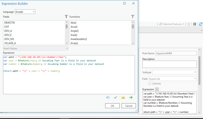

I wrote an expression without errors, but the result is incorrect.
Is the expression written incorrectly, or is there another solution?
Please help
Expression:
var path = "\\192.168.10.20\\ls\\Number\\Year";
var year = $feature.Year; // Assuming Year is a field in your dataset
var number = $feature.Number; // Assuming Number is a field in your dataset
return path + "\\" + year + "\\" + number;

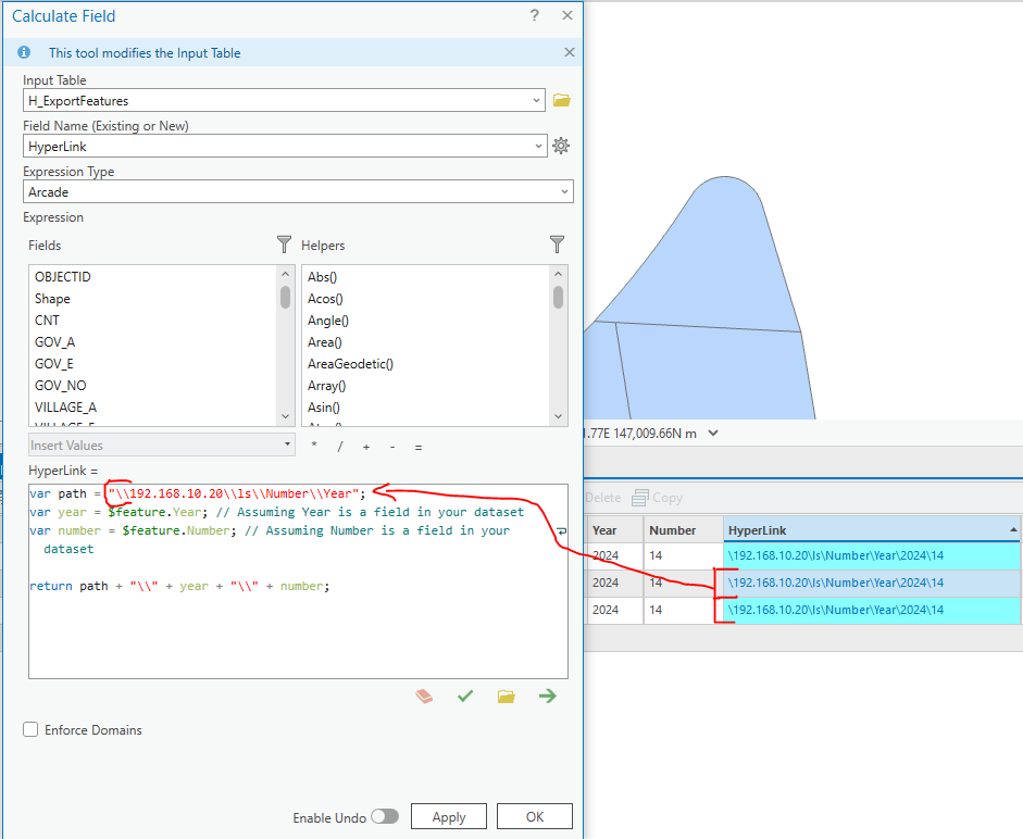

I wrote "\\" but the result shows \, so the result is not required and the path cannot be accessed.
Please help

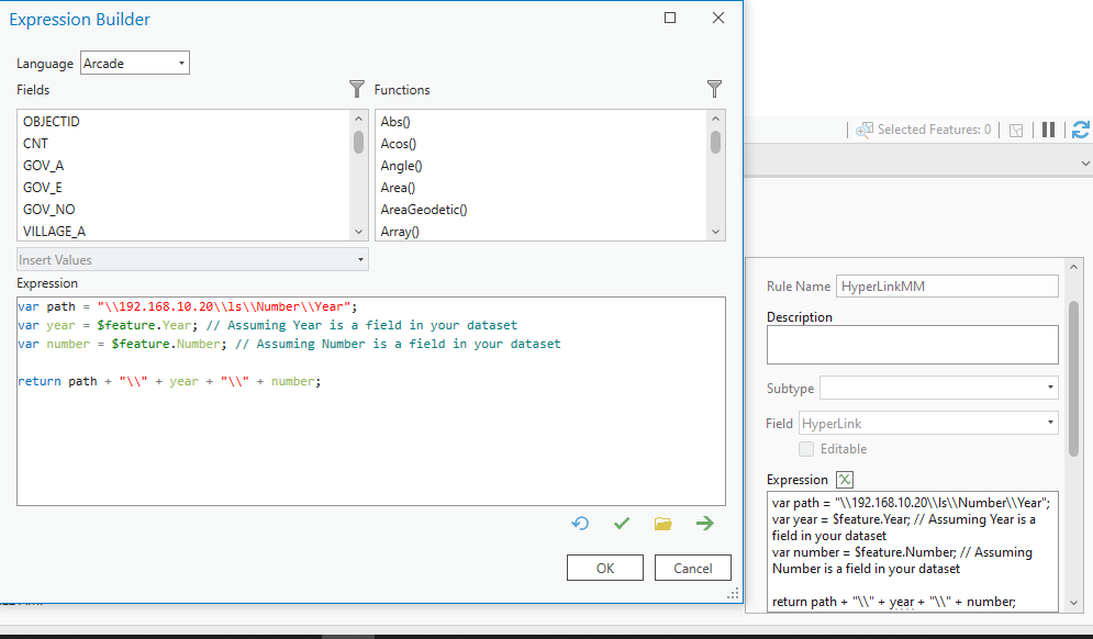

If you need two backslashes I would try in any string "\\\\" in any string you need it.
one backslash is like a command "\n" breaks a new line "\t" is a tab, and so on.
"\\" means draw a single backslash.....if you want 2, a guess you need 4, right?
Could you try it?

I clicked "Ctrl + 'Click'", but the link could not be opened.
The path is inside the organization's server. If you copy and paste it, the process is completed successfully, but the expression cannot open the link.

I added "\\\\" instead of "\\", and the process succeeded.
