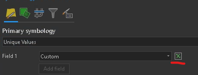

Hi,
I've read lots of forum questions and tips but don't know how to solve my case.
I am using the expression generator to create 2 symbologies. I have a table with 5 fields/
I would like to define 2 groups:
  • Group A: features with 2 (or more) fields non empty
  • Goup B: else (features with only one non empty field)
