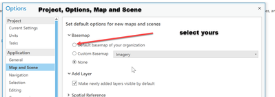

How would I go about making a custom basemap that I can save and use again in multiple projects within ArcGIS Pro?

Then from the Project backstage
