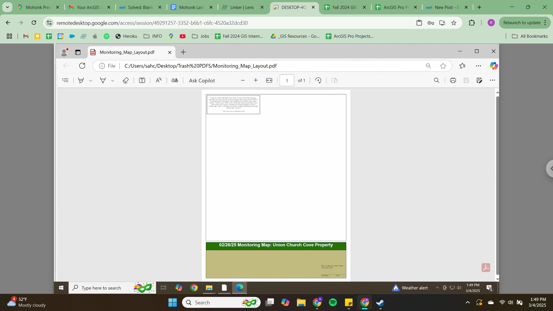

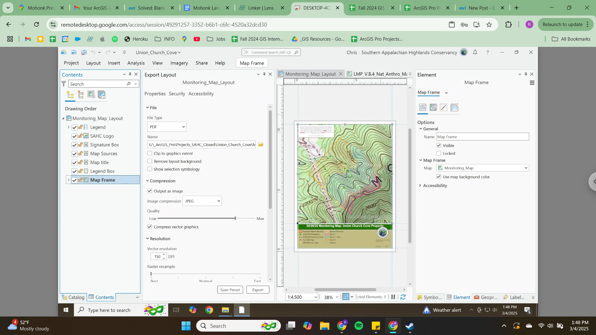

Hello all, I am working on ArcPro 3.4.2 and am having trouble exporting my map frames in a layout. When I share the layout as a PDF or JPEG the map frame and associated legend show up blank. I am using all the default export settings and map frame settings. The image shows what the layout should look like and the map frame properties and the other image shows the blank result of exporting the layout.
It seems to be happening on newer created projects and copying the layout to the clipboard and pasting somewhere else doesn't have the same issue. Any help is appreciated.
