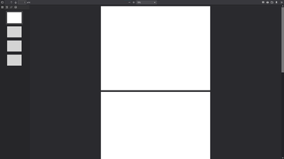

wayfaringrob
Honored Contributor
Gah, forgot about this bug and sure enough. Tried to combine files in Acrobat today and this is what they look like. I really don't want to have to flatten my maps into raster.
