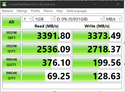

Bigfoot48
I think it is an bandwidth issue. You could try and install CrystalDiskMark and run on the specific disk.
CrystalDiskMark - Crystal Dew World [en] (crystalmark.info)
Try a different usb port, preferably usb3 or higher.
