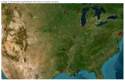

Issue: Export Training Data for Deep Learning takes unexpectedly very long time when the label features are sparse; it also reach to 100% in a few minutes but continue to work for several minutes (or, hours or days) depending on the inputs. In below case, there are 1600 label features. The tool will export ~90 items and then stop for a long time, then goes to another extent and exports......it may take hours or days.
About my test case:
There are 1600 labels features and they are spread over entire USA but geographically  they can be clustered in 12 areas.
PavanYadav_0-1695412828392.pngPavanYadav_0-1695412828392.pngPavanYadav_1-1695412851694.pngPavanYadav_1-1695412851694.png
Workaround 1 You can use current extent for each areas and export chips one by one for each areas. You can either append existing folder or use multiple folder
Workaround 2: for each sample areas create a mask feature, with 12 rectangles around the 12 areas in the map above. Use this mask feature class as input to the tool.
