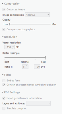

I regularly export georeferenced pdf maps and was able to do so easily with Arcmap (~30 sec). For some reason, ArcGIS Pro takes forever to export even the simplest ones (~15 mins) which greatly impact the efficiency of my work. More exactly, it's the "Preparing export" step that seems to be the problem. Once this step is done, the map is exported in a second. Finally, using basic settings such as these doesn't speed up the export in any way.
