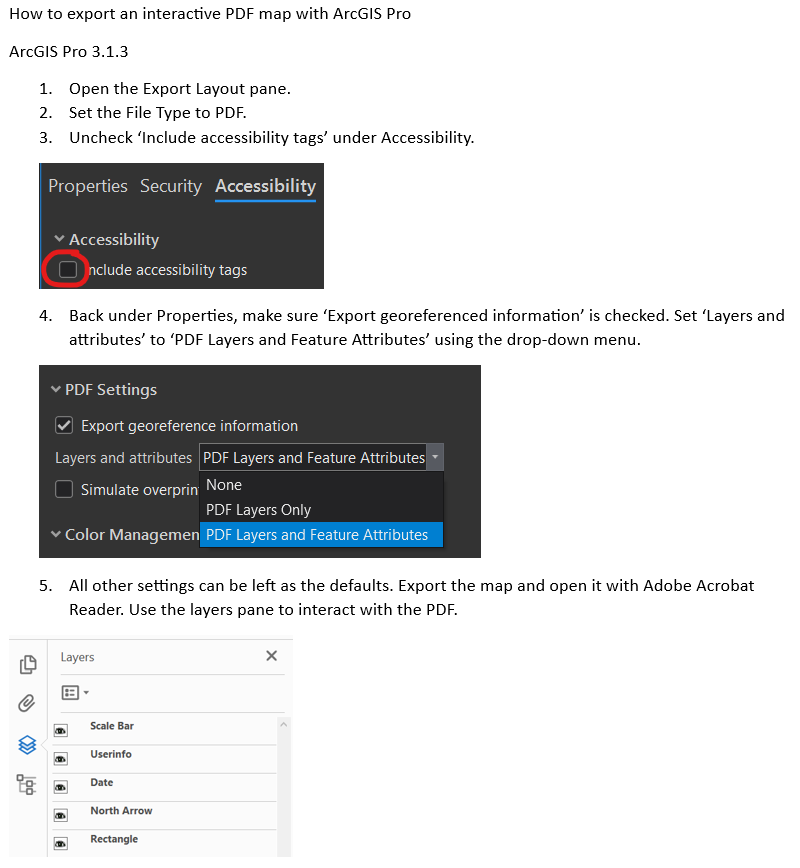

It might be due to this option from the Help:
AustinT
I am late to this post, but here is an instruction set I created to implement the solutions users contributed here.
