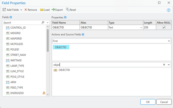

DanSadler1
I found this thread searching on the same issue. For what it's worth, we found a solution not mentioned here. I'll post below in case it's useful to people who surf into this thread:
  1. Under the Fields section of the Export Table window, click the Add Fields dropdown and Add Empty Field
  2. Name the newly added field OBJECTID
  3. Click the pencil icon and define the source of the new OBJECTID field as the OBJECTID virtual field (you can search for the word "object" to find it)
4. As the newly added OBJECTID field is added at the end, click and drag to move it to the top
A CSV exported after following these steps should include a populated OBJECTID field as expected.
