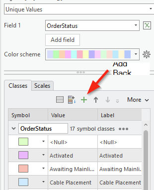

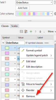

If this is symbology, you may be able to right click, go to symbology, and if it is a set of unique values, you should be able to right click on the symbol you would like to exclude from the legend and press Remove, this can be added back through the same window, but with the green plus sign, here are some screenshots:
This method will remove unwanted legend entries if symbology is the issue.

This works. The other setting I would try is: Only Show Features in Map Extent in the Legend, but that only takes care of the issue in Layout view.
The green Plus sign that Cody mentioned can also be used to add symbols for values that don't exist yet, which can be handy if you're trying to set up symbology in an empty file.

Luckily I figured out the solution, the icon "Add all values" next to the green plus sign updates the records.

I actually figured out the solution after posting this question and it was something to do with Symbology. The "Add all values" icon next to the green plus sign updates the records to the ones selected during the export features process.
