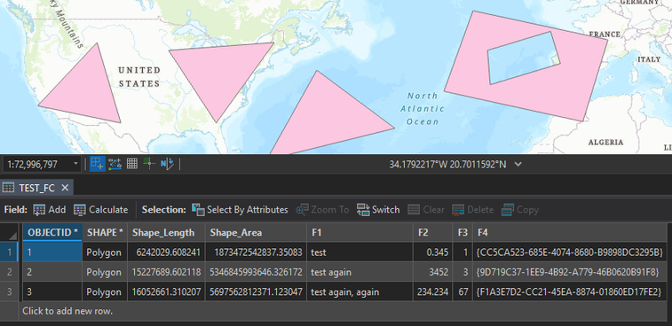

I'm not super familiar with WKT representations of geometry objects, but would something like this work for you?
import arcpy
import csv
# Leave the quotes and the leading "r" in both lines below. Replace my text with your paths.
input_fc = r"THE FULL PATH TO YOUR FEATURE CLASS"
out_csv = r"THE FULL PATH OF A CSV TO BE CREATED"
# Get all the field names. Explicity specify "SHAPE@" for the full geometry object.
fields_curs = ["SHAPE@"] + [f.name for f in arcpy.ListFields(input_fc) if f.type != "Geometry"]
# Create a writeable CSV file. Create the writer object.
with open(out_csv, "w", newline="") as csvfile:
    csvwriter = csv.writer(csvfile, delimiter=",")
    csvwriter.writerow(fields_curs)  # Remove this line if you don't want headers.
    # Write each row in the feature class, including the WKT geometry, to the CSV.
    with arcpy.da.SearchCursor(input_fc, fields_curs) as scurs:
        for geom, *flds in scurs:
            csvwriter.writerow([geom.WKT, *flds])

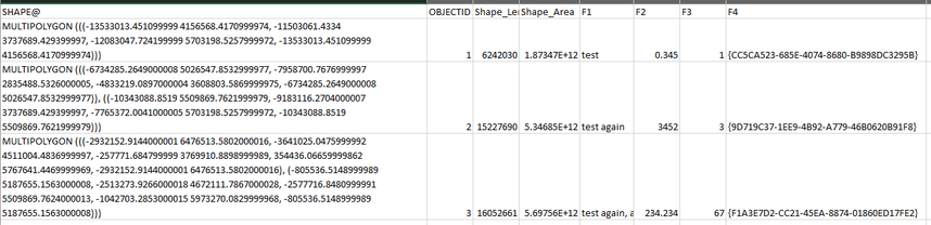

Assuming you replace the two variables at the top with your actual paths, this should give you an output that contains those geometries as WKT. After updating those variables, you should be able to copy/paste this directly into the Python window within ArcGIS Pro.
OID 2 is a multipart polygon. Output:
Assuming I have understood what you're after, this would allow you to stay in the Esri environment. But, if all it takes is a couple clicks in QGIS, then that sounds like a pretty good option too.
