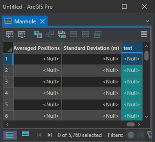

Example: Here is a manhole with a field [test] where all the records are NULL

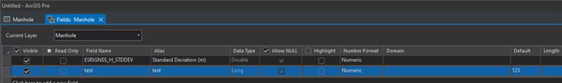

In Fields View I set the Default to 123

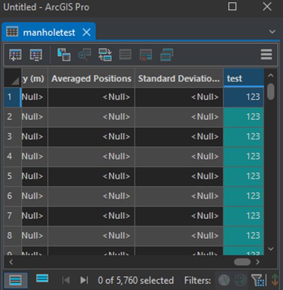

Exporting the feature layer to another feature layer populates that Default value in all the records that are NULL
There is no warning that the records with NULL values will be changing.
