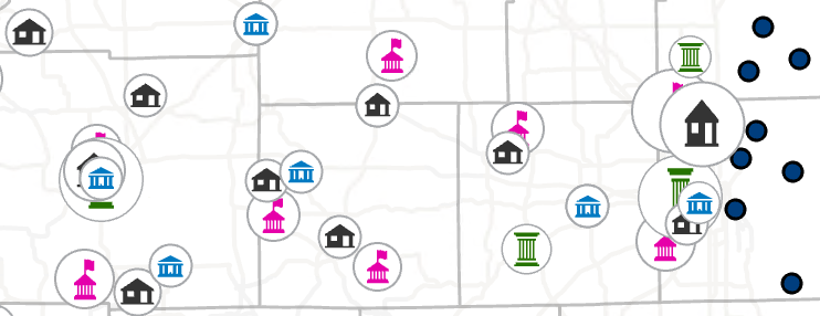

Hello all,
How can I export the clustered data as Points from ArcGIS Pro after I use the Feature Layer - Aggregation - Clustering?   https://pro.arcgis.com/en/pro-app/3.2/help/mapping/layer-properties/work-with-clustered-feature-laye...
I tried reproducing the layer with Find Point Clusters https://pro.arcgis.com/en/pro-app/latest/tool-reference/big-data-analytics/find-point-clusters.htm ,then Dissolve, then Feature To Point.  https://community.esri.com/t5/arcgis-pro-questions/merging-multiple-points-into-one-point-depending/... and this gets me really close. But not the same as when I use the Clustering for the display. I tried different search distances in Find Point Clusters but Clustering from the Feature Layer ribbon just looks better and seems smarter.
Why would I want to export the center point of these clusters? Well, I have 4 layers that I'm clustering for symbology. And they overlap. So I wanted to use the Cartography - Disperse Markers tool https://pro.arcgis.com/en/pro-app/latest/tool-reference/cartography/disperse-markers.htm . I figured if I could get all of the center points of the clusters from my 4 layers, I could merge them into one Point layer and run that Disperse Markers tool.
Any ideas for other work arounds?
