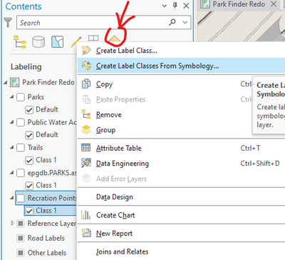

In Pro, you can use a command Create Label Classes from Symbology:
This will automatically create SQL queries that match your symbology if you're using Unique Values.

Thank you Zach. Using the create label classes from symbology to create distinct labels for each treatment works perfectly. I am creating a map for my marking crew, and this will let me clean-up my may by removing those unnecessary labels. The other symbol class is mastication, and those units don't have to be marked so I don't need to include it in my map. Those polygons will be addressed in a separate contract, but I didn't want to create a separate polygon layer because things can get disorganized quickly.
