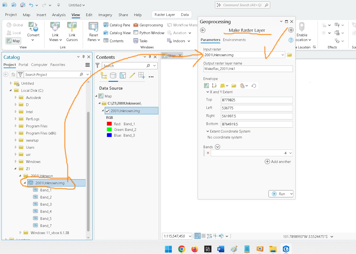

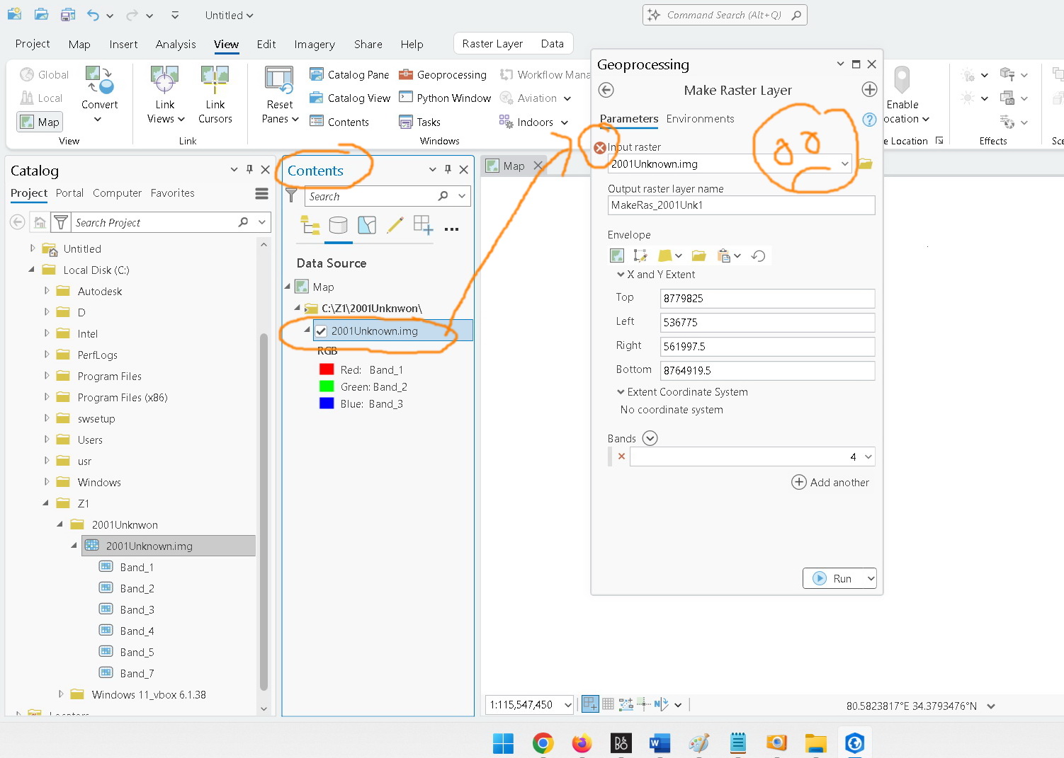

In the screenshot below, adding the imagery from the Contents pane to the tool produces an error, while adding the same imagery from the Catalog pane results in no errors.
What is the explanation behind this behavior?

In this case, I would assume that you can't make a raster layer from a raster layer, which is what's happening in the first screenshot. Make Raster Layer needs a data source, and layers, by definition, are not data sources.
Make Raster Layer (Data Management)—ArcGIS Pro | Documentation
It will also take a layer file as input, but the same thing happens: it reads the layerfile for the data source and then pulls that in.

But the physical source of each layer in the Contents pane is known, so it is assumed that the layer is recognized based on its physical location on the drive.
