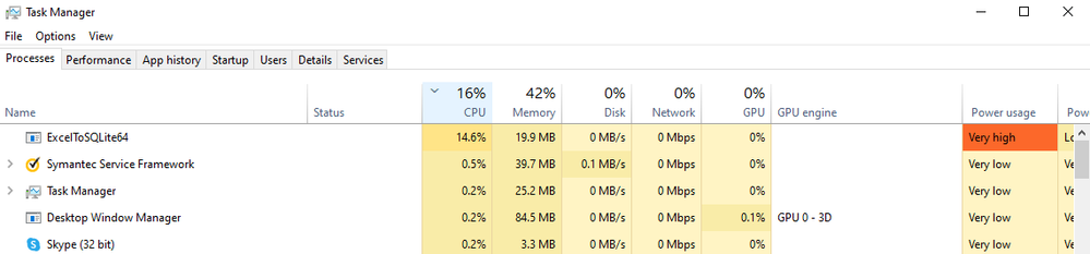

NOTE: My laptop was completely off this morning when I turned it on (not on sleep mode)
This ExcelToSQLite64.exe process keeps using my CPU when I plug in my laptop (i.e. when switching from battery to plugged-in power). This happened after I updated to ArcGIS Pro 3.0.1 (from 2.9).
This is not an issue of ExcelToSQLite64.exe not closing after starting ArcGIS. I have NOT used ArcGIS at all today nor even started it. This process shouldn't be active at all let alone stealing a substantial portion of CPU power.

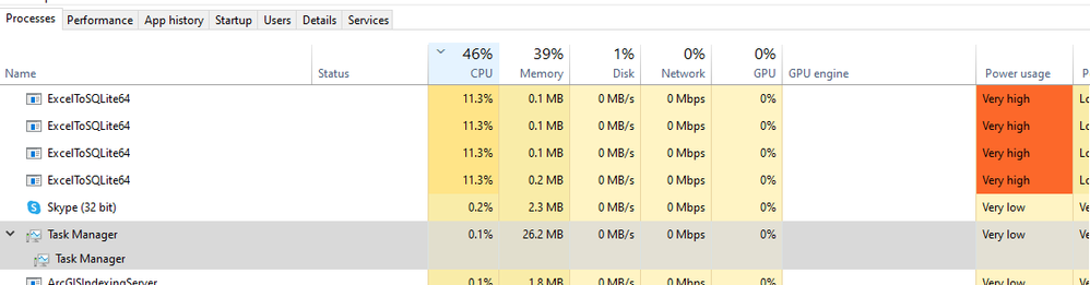

RobertHudson1
Same issue here. I have two instances running all the time each consuming 8.6% of CPU. Crazy!
