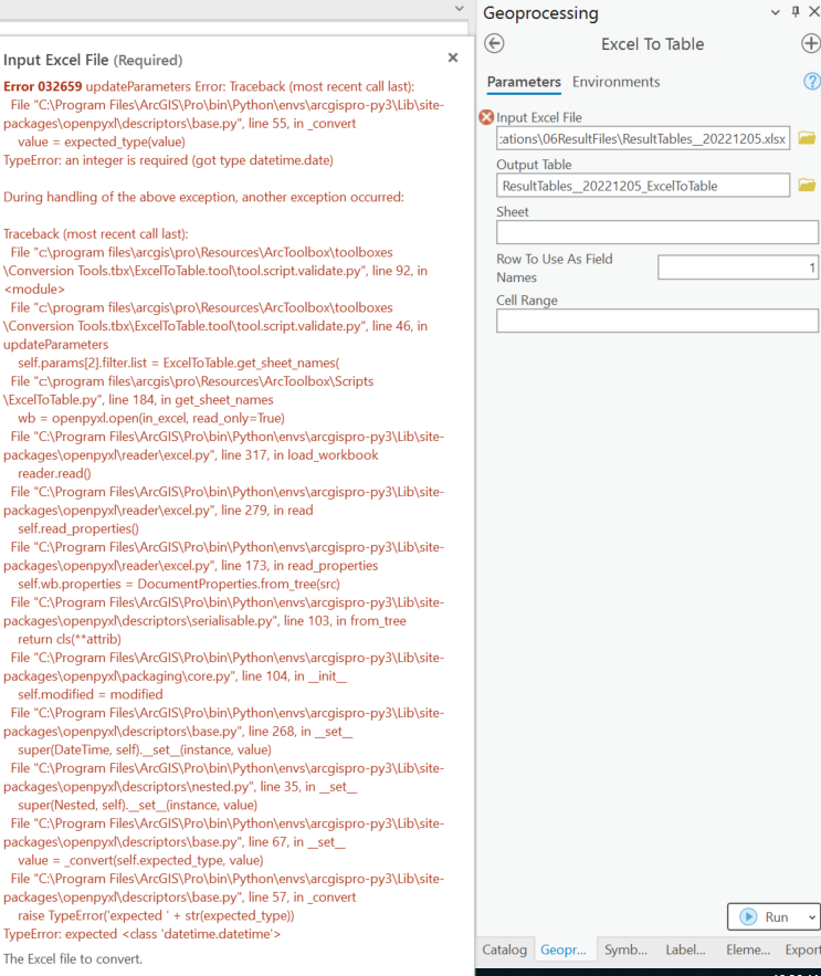

Not sure why it is not working.
It gives me this error as soon as I put in any file path. I have tried a few different excel files, tried them in other programs and they seem fine. The error is pointing to a GIS program that I do not know too much about, I opened it and it seems like fine code. Not sure what to try next. Picture of the error:

move the *.xls file to a folder with a much shorter path to rule that out as an issue.
What is the full path for the output?  It should be a shorter name and it should be going to a geodatabase (preferably)
Is there only one sheet?
Anything else you can provide?

I moved the file to my desktop and got the same error.
It is only one sheet.
Output path is going to the gbd: C:\Users\a.ya\OneDrive - Center for Health\Desktop\GIS Project 22\Region Map\ Region Map.gdb\HDD_Utilization

put it in c:\Data
"desktop" is not a folder
OneDrive is not a drive
put it in
c:\Data\Region Map.gdb\HDD_Utilization
make c:\Data or replace it with a simple folder

I moved it to several different folders to try this and got the same error each time
DanPatterson
MVP Esteemed Contributor
if it works with other spreadsheets and not this one, there may be something wrong with it.

I had this problem and resolved it by converting the cells in the excel file to numbers.
