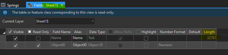

As an example, I opened an Excel worksheet quickly in Pro and I also saw that the field length was 255.  But my attributes weren't longer than that.
So I made a 1 record Excel sheet where the value had more than 255 characters (around 260ish).  When I add that to Pro, here is what I see as the length:
So depending on the answers to the above questions, you could move some of the longer records up to the top of the worksheet... or save as a CSV and bring that in.  Typically when I add csv data directly, Text fields come in with a length of 8,000
though that an also be controlled with a schema.ini file: Add an ASCII or text file table—ArcGIS Pro | ArcGIS Desktop
Does this help?
