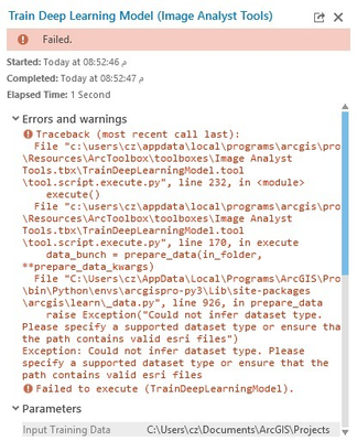

I am trying to run train deep learning model tool, unfortunately, I got the error in the screenshot

Hello,
This error may indicate training data issue, Have a look on the following post it could help you fix the issue
https://community.esri.com/t5/arcgis-api-for-python-questions/arcgis-learn-prepare-data-error-callin...

Robert_LeClair
Esri Esteemed Contributor
Are you licensed for Image Analyst by chance?  The error is talking about an Image Analyst toolbox it seems so I'd check my licensing first.
Noha
Thank you very much,
Yes, image analyst is licensed
So, I uninstalled ArcGIS pro 2.7
Then, installed ArcGIS pro 2.6 and the deeplearning framework

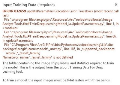

According to the tutorial https://learn.arcgis.com/en/projects/use-deep-learning-to-assess-palm-tree-health
https://learn.arcgis.com/en/projects/use-deep-learning-to-assess-palm-tree-health/
Unfortunately I get the error in the photo while selecting the input data that obtained from export training data for deep learning model
