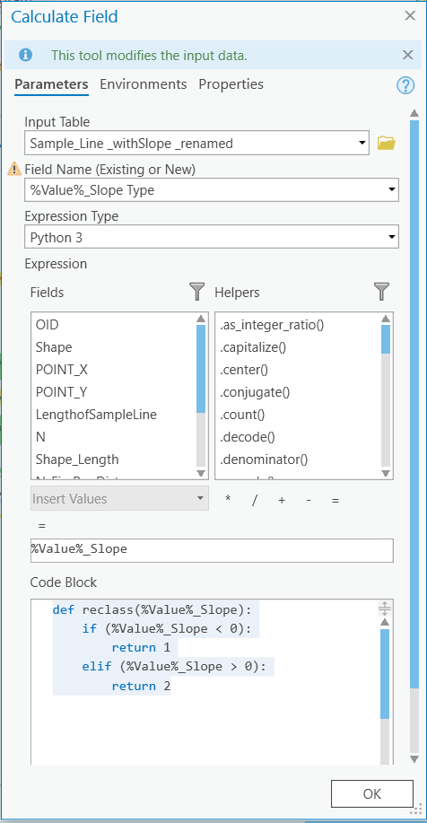

Hello, I am having trouble reclassifying slope value into a new field.
I have attached an image with the dialogue box for the calculate field tool, including the code I am using.
Something(s) to consider - I am using the tool in the workflow for a model and have used an iterator before the tool. Hence the "%Value%_Slope_Type"(Inline variable substitution). I also tried executing the tool outside the model but I get the same result.
The error message I receive is as follows -  ERROR 000013: N_Slope_Type already in N_Sample_Lines
Failed to execute (Calculate Field).
I am using ArcGIS Pro version 2.9.0.
Any help would be greatly appreciated.
Regards, Kedar

Not sure with inline substitution but normally the expression box you call the def in the Code Block and pass the field variable.
Instead of %Value%_Slope, try this:    reclass(!%Value%_Slope!)

Also, you have a space in the new or existing field name, remove it or replace it with an _ .

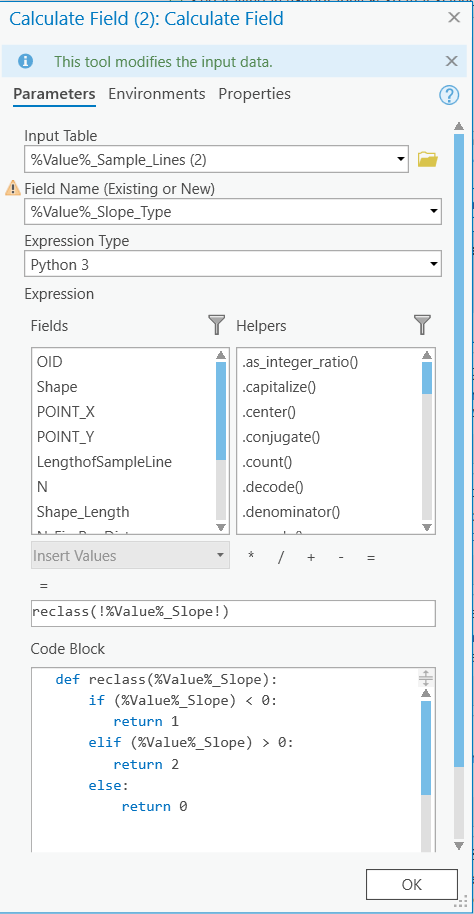

Hi Curt. It worked!
Here's what I did -
- I inserted an Add field before the calculate field as you said.
- The details of the calculate field are in the image of the dialogue window -Calculate field error while reclassifying slope FIXED.PNG
Thank you so much, Curt!
