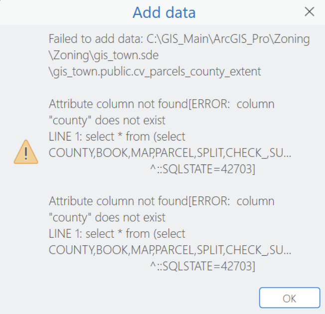

I have a PostgreSQL database with the PostGIS extension that I have connected to successfully and want to add features to the current map. I right click and select 'Add to Current Map' and I get the following error message.
'Attribute column not found[ERROR; column "county" does not exist Line 1: select * from (select COUNTY, BOOK, MAP, PARCEL, SPLIT, ...'
I read somewhere on the ESRI forums that both the database column names need to be in lowercase. I would recommend that the error message be improved to detail that fact.

I am commenting to show a solution for those who have the privileges to add functions and are comfortable with PostgreSQL.
 Within psql (PostgreSQL terminal) or pg Admin 4, create the following function:

Now, you can call on that function to make all of the columns lowercase within a given table:
# Input in the form
# SELECT rename_columns_to_lowercase('schema', 'table');
SELECT rename_columns_to_lowercase('public', 'cv_parcels_county_extent')
After refreshing the connection within ArcGIS Pro, you should be able to add your data to the map. You might be prompted to select a primary key from one of your columns before you can add the table.
