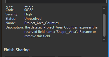

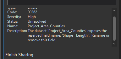

I uploaded a feature class as a feature service from Pro. I then went to overwrite the layer after joining a few more fields with the Join Field tool. Now, I get error messages from Analyzer:
Here is the documentation for that error code, which suggests renaming or deleting the field. The problem is I didn't add those fields -- the join did, despite not checking them under Transfer Fields. There are also other fields in my dataset now that I did not select. I cannot rename or delete Shape_Area or Shape_Length and am now stuck unable to update my feature service.

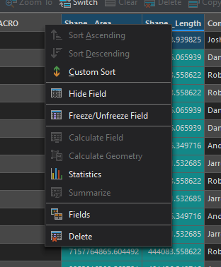

I got it - for some reason, though I wasn't able to delete the fields from the fields view, I was able to delete them from the table view (noticed it lit up when I was on the way to the fields view).

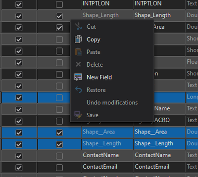

Delete is grayed out, and double-clicking or F2 in the field does not allow renaming:

One option, in the Fields Designer, uncheck the visibility of the recently joined fields - Shape_Area, Shape_Length, and perhaps ObjectId from the join table schema.  Then try to overwrite the web feature layer again.  What is the result?
wayfaringrob
Honored Contributor
@Robert_LeClairI did try that, it still "sees" them.
