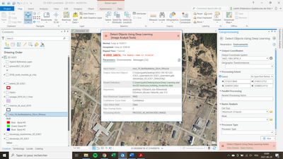

i trained the model now for detection of objects by deep learning the error as below stoped the process:
ERROR 160676: The domain name is invalid.
Failed to execute (DetectObjectsUsingDeepLearning).
below is the screenshot of parameters i used
how should i deel with that and what is the problem
i will be so grateful if anyone have a useful recommendation

Hi Judith what version of pro are you using?
I am currently on 2.7 which seems to be the problem. ESRI analyst tried my data with 2.8 installed and it worked ok.

Hi Andrew,
Bullseye! I reinstalled the deep learning plugin and it fixed the issue.
Thanks,
